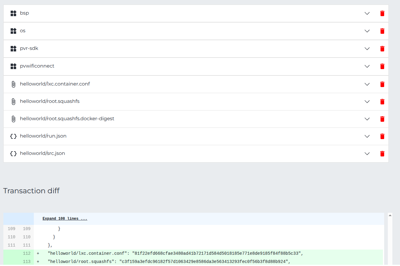

  2. Begin a transition. On the web page, click on “begin transition”. This initiates the process of updating the device’s configuration.
  3. Upload the .tar.gz file. Simply drag and drop the helloworld.tar.gz file you created earlier into the designated upload area.
transction transction
  1. Commit the transaction. Follow the on-screen prompts to commit the changes. The Pantavisor system will handle the rest. Check the serial console for logs, if a reboot is issue and an a debug shell is running a timeout will start before the reboot. Follow the instructions of the console to reboot the device.
